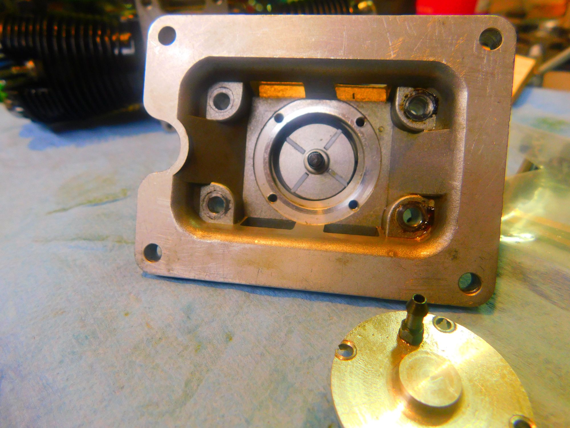

New vanes installed, confession is due, all four vanes are facing the wrong way and the rotor needed to be reversed, the shoulder you see needs to be inside. Lived and learned before I wrecked it. It's all back together now and turns freely. Freely is good.
