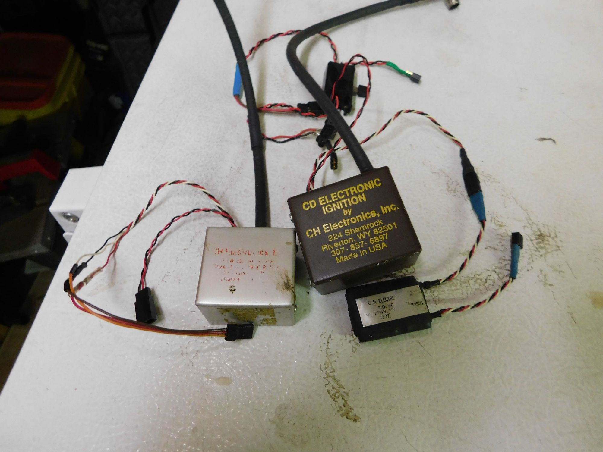

The unit on the right has the Synchro Spark unit in line with the sensor, soon after they were built into the module. They retarded the timing to 6 degrees btc when set at 28 btc, they went to full advance by 2,500 but some for larger engines were all in at 1,500.
