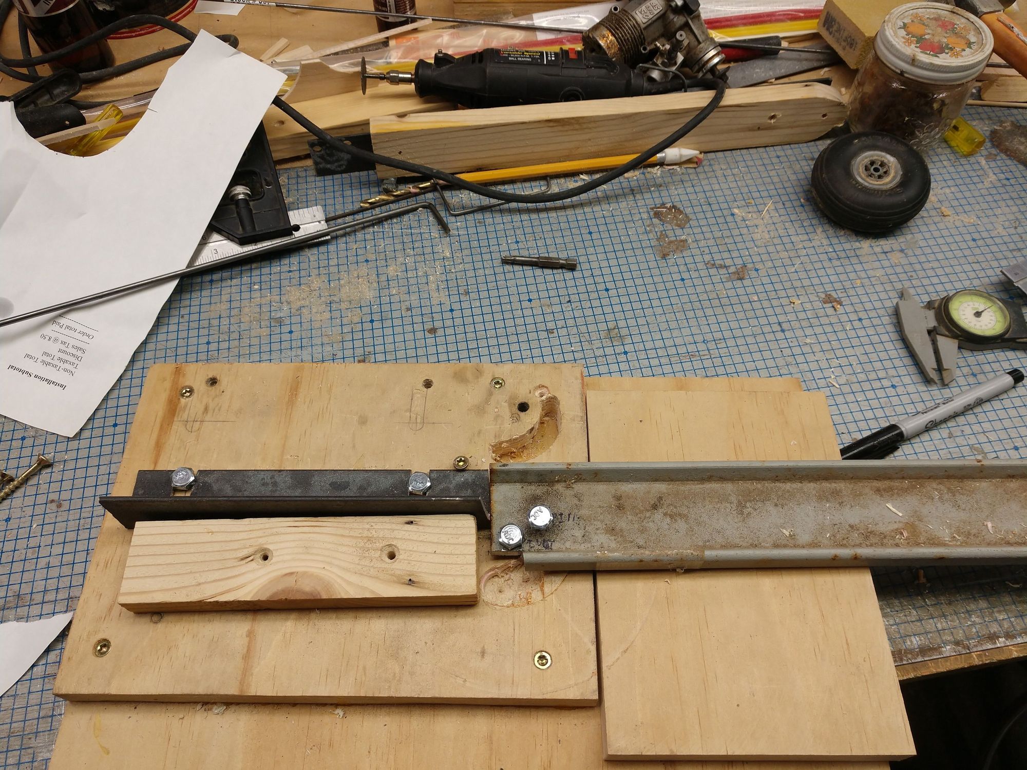

The backing bar (left) has slots cut in it so it can be adjusted for different sizes of wire. The bolt closest to the bottom of the pic is the pivot pin. The wire bends around it. The bolt just above and right is the bolt that actually bends the wire It has to go below the top of the base so I used a Fostner drill bit and wood chisel to re-leave a slot for it in the base.
