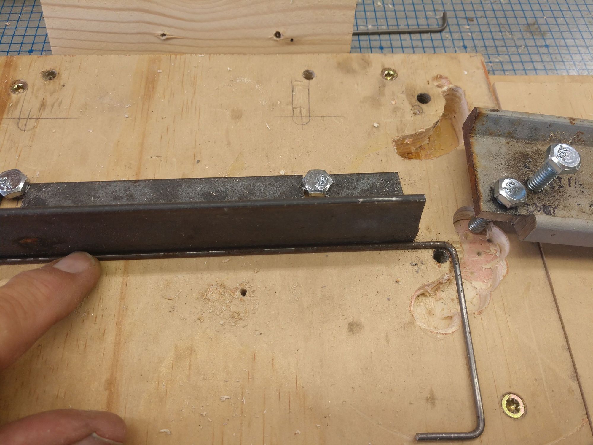

You can see the slot for the bending bolt. the bolt needs to go below the base to get flat bends. With sturdier construction so the was no play in the handle the slot might not be needed
The hole at the top bend is tapped for a 1/4 20 bolt, This is the pivot.
