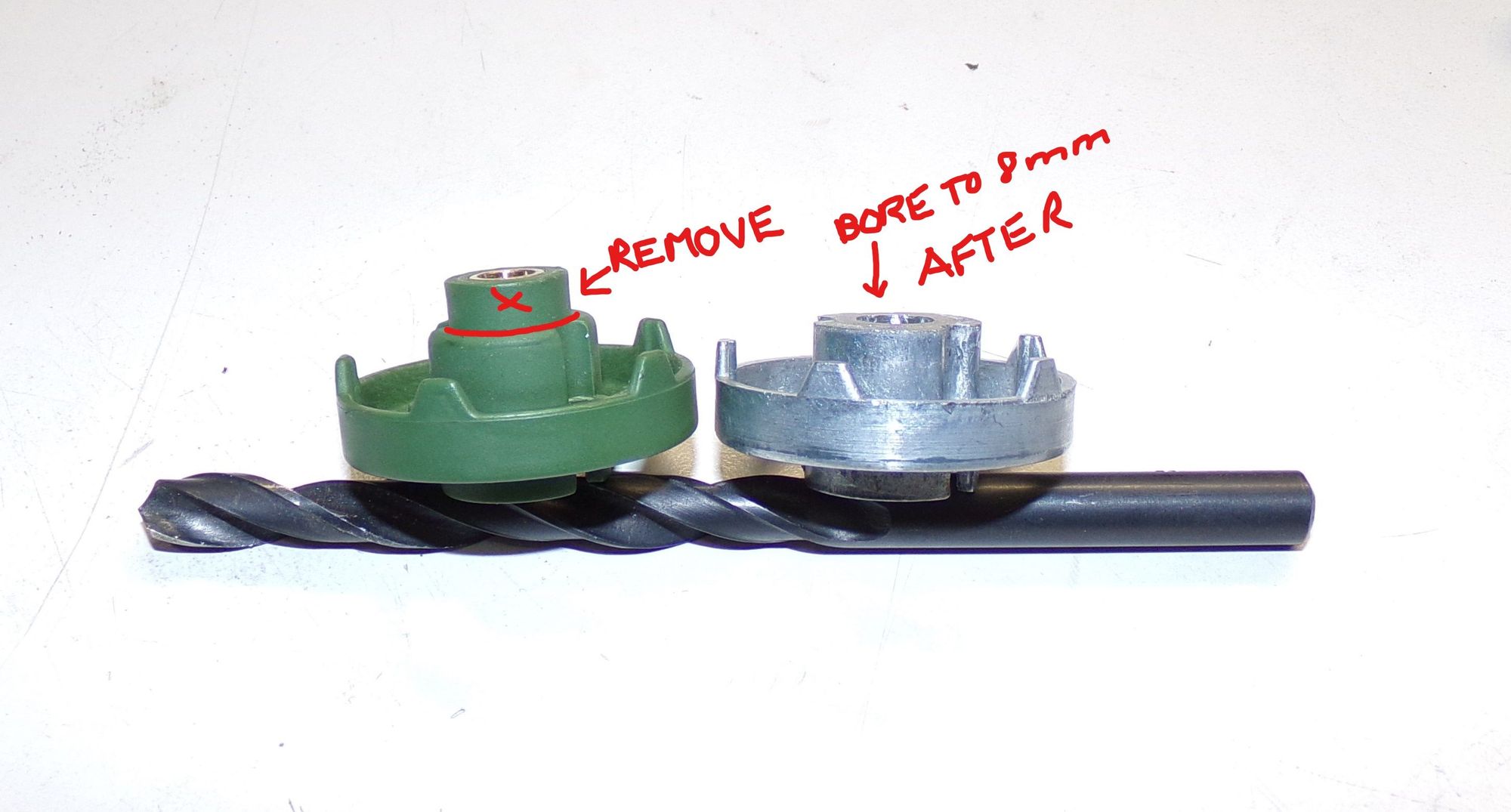

Due to how far the brace sticks out I had to remove part of the sprocket hub. I removed the brass bushing from the plastic sprocket and bored the idler to 8mm on my lathe to accept the brass bushing. I may fit bearings later, but the bushing is fine for now.
