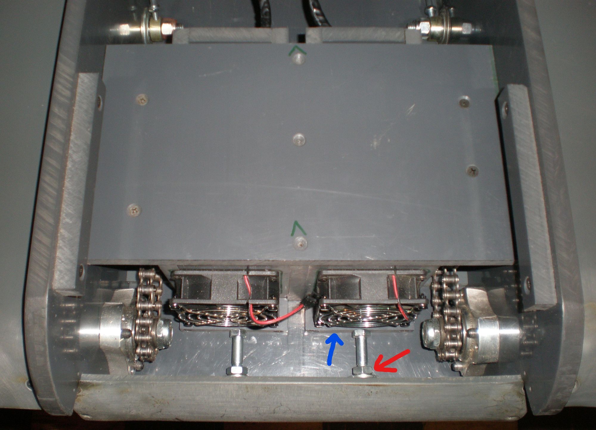

Motors mounted to sleds basically. As the nut (red arrow) is loosened, it pushes on the back of the tank elongating the bolt which pushes the motor sled toward the front of the tank (blue arrow) taking up the slack.
