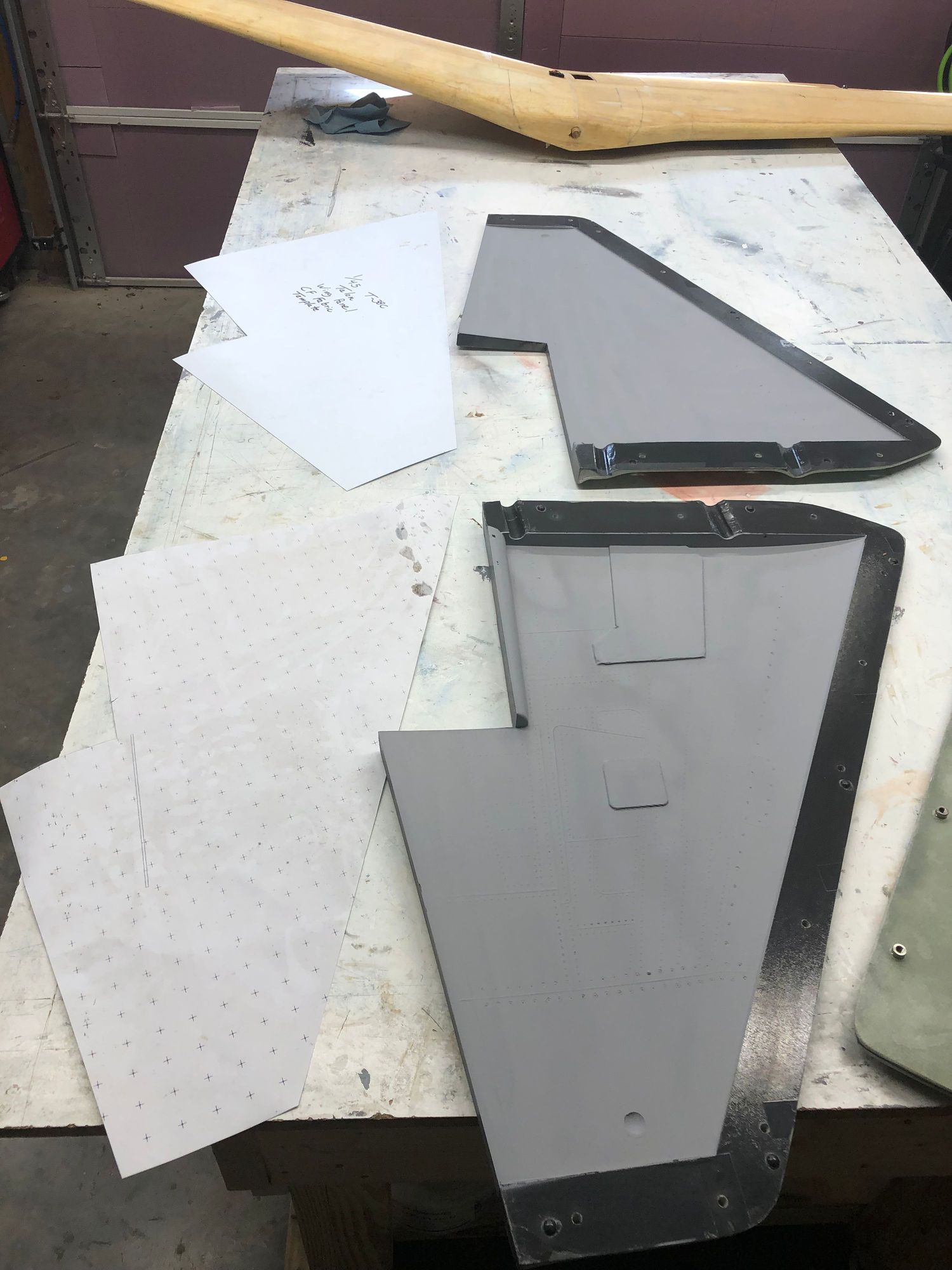

Paper airex core template is used for testing the fit prior to cutting the core from raw sheet on the laser cutter. A hard plastic template is made to simplify cutting out the carbon fiber layers of the wing panels. The fiberglass layers are cut on the laser cutter.
