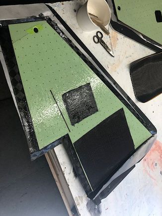

The inner layers of carbon fiber reinforcement on the top wing skin are put inplace on the airex core. These reinforcement pieces are around the main landing gear mount and the servo mount.
