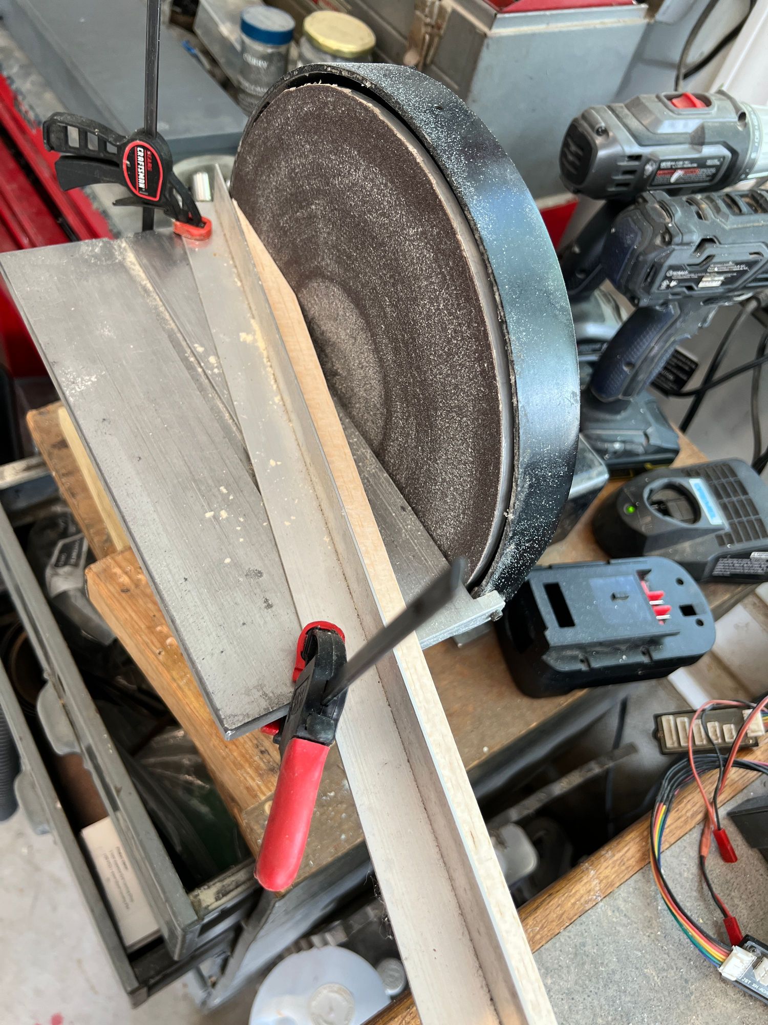

mitchilito June 22, 2022
This is how I do my scarf joints. I'm using this angle (approx 12:1) because the JW uses this ratio on other pieces provided. It also happens to be aircraft industry standard.
