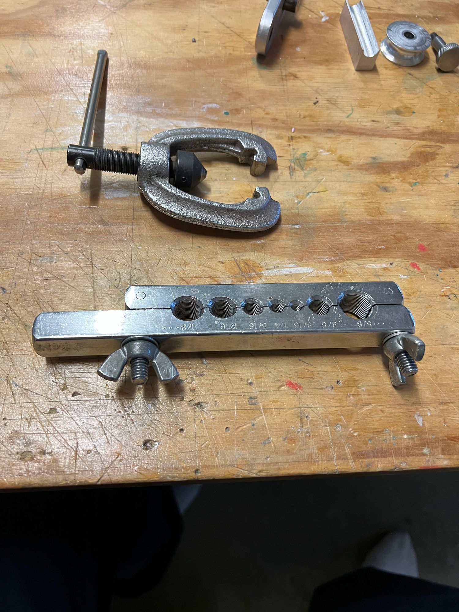

I started every bend with a flange already on the tube. This is how I flanged. First I used the "normal" side of the clamp rig to start the flange (with round end of a small ball peen hammer). This side has a bevel on the lip. Once bevelled I move to the other (flat side of the rig). . . . .
