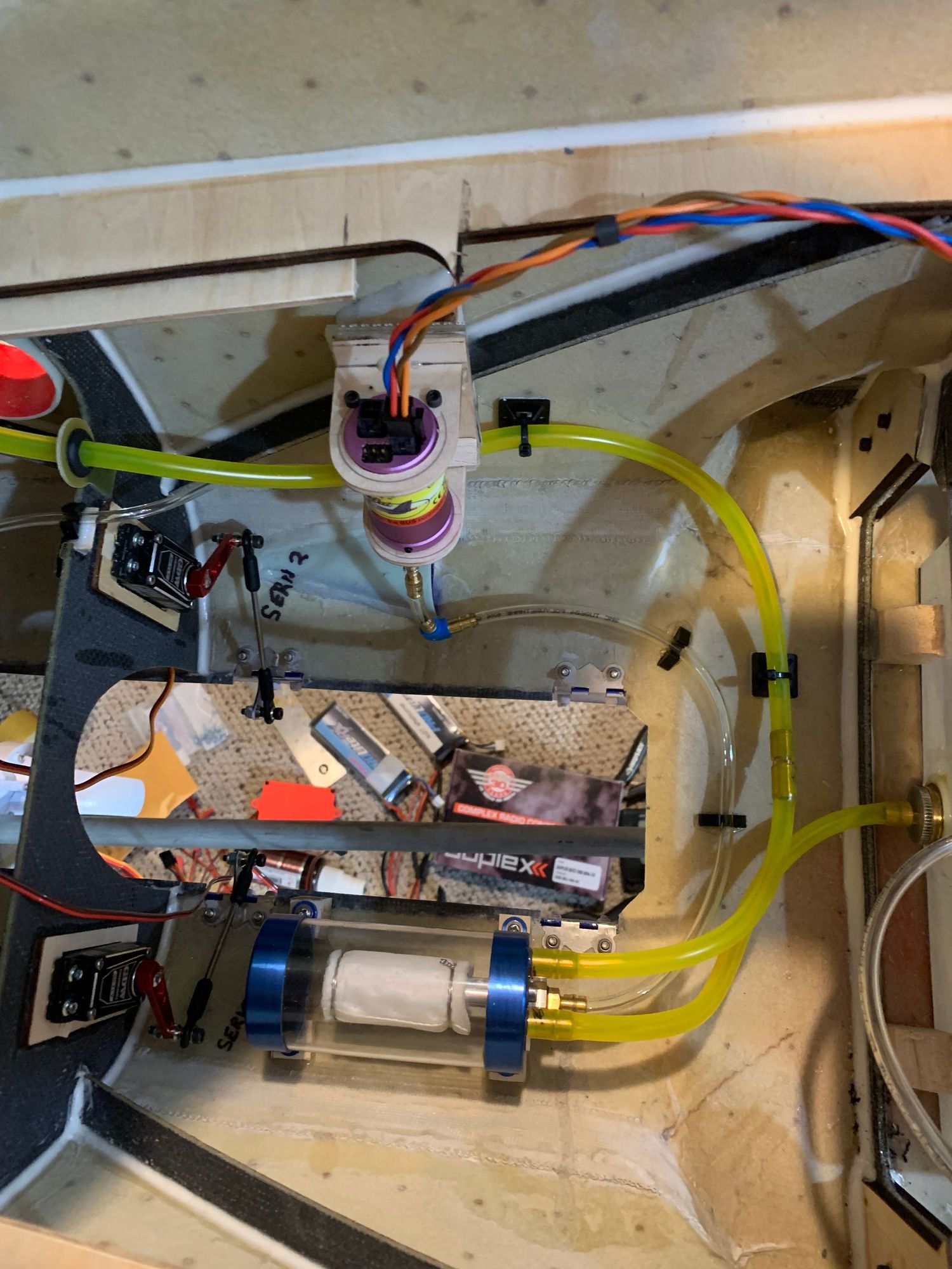

Fuel system plumbing almost done. Kept all this on fuse bottom with pump mounted vertically on the right side. Keeping everything ahead of CG. Still need to mount vent in bottom of fuse
