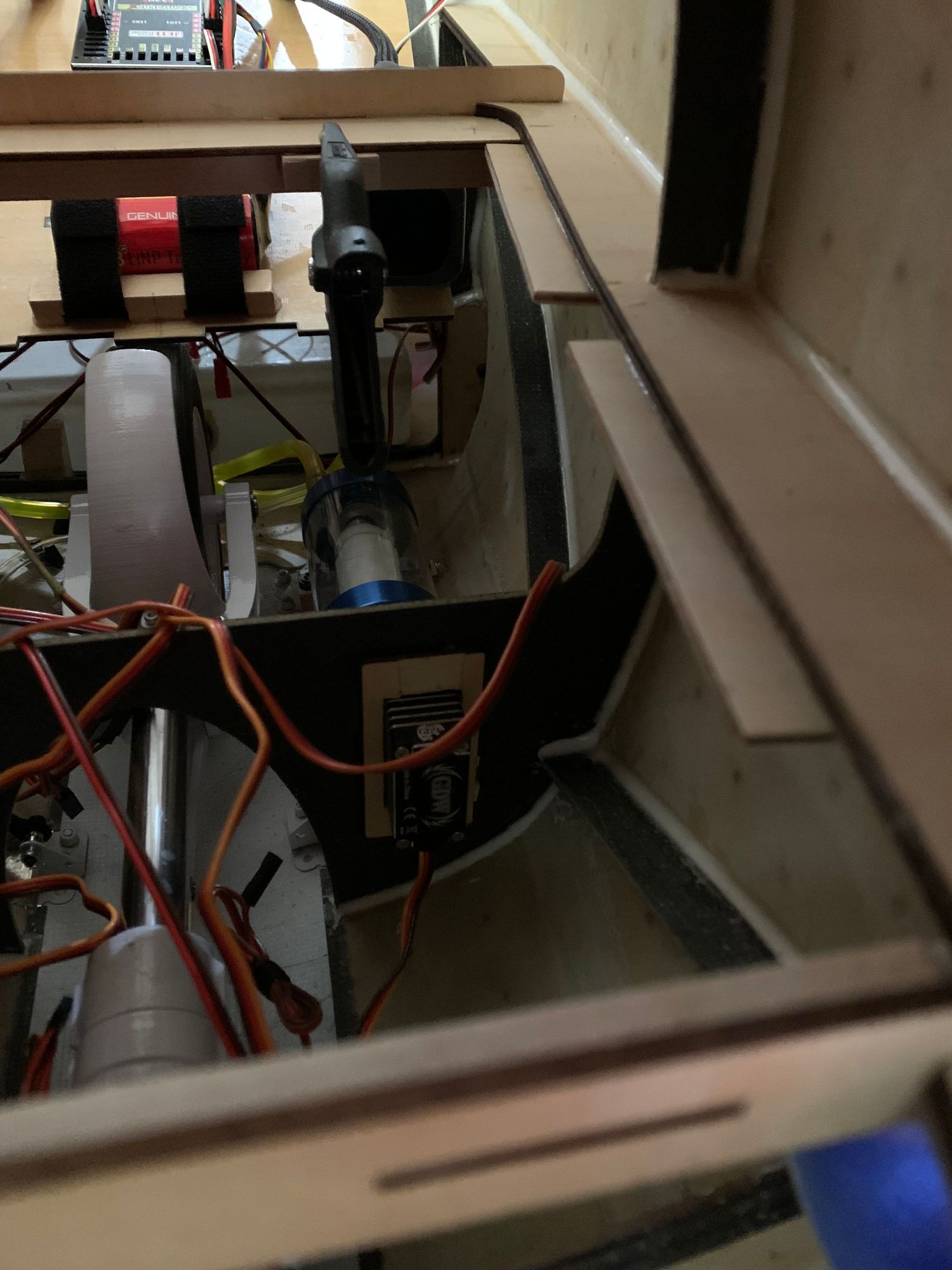

Plywood extensions to support electronic tray placed on both sides. Also used 3/8 x 1/2 inch hardwood supports glued horizontally under front and rear supports. To increase rigidity of the tray (gyro will be mounted on it) I fiberglassed the top of the tray with lightweight cloth and resin. Also added some reinforcement under the tray where gyro will sit to keep out any unwanted vibrations
