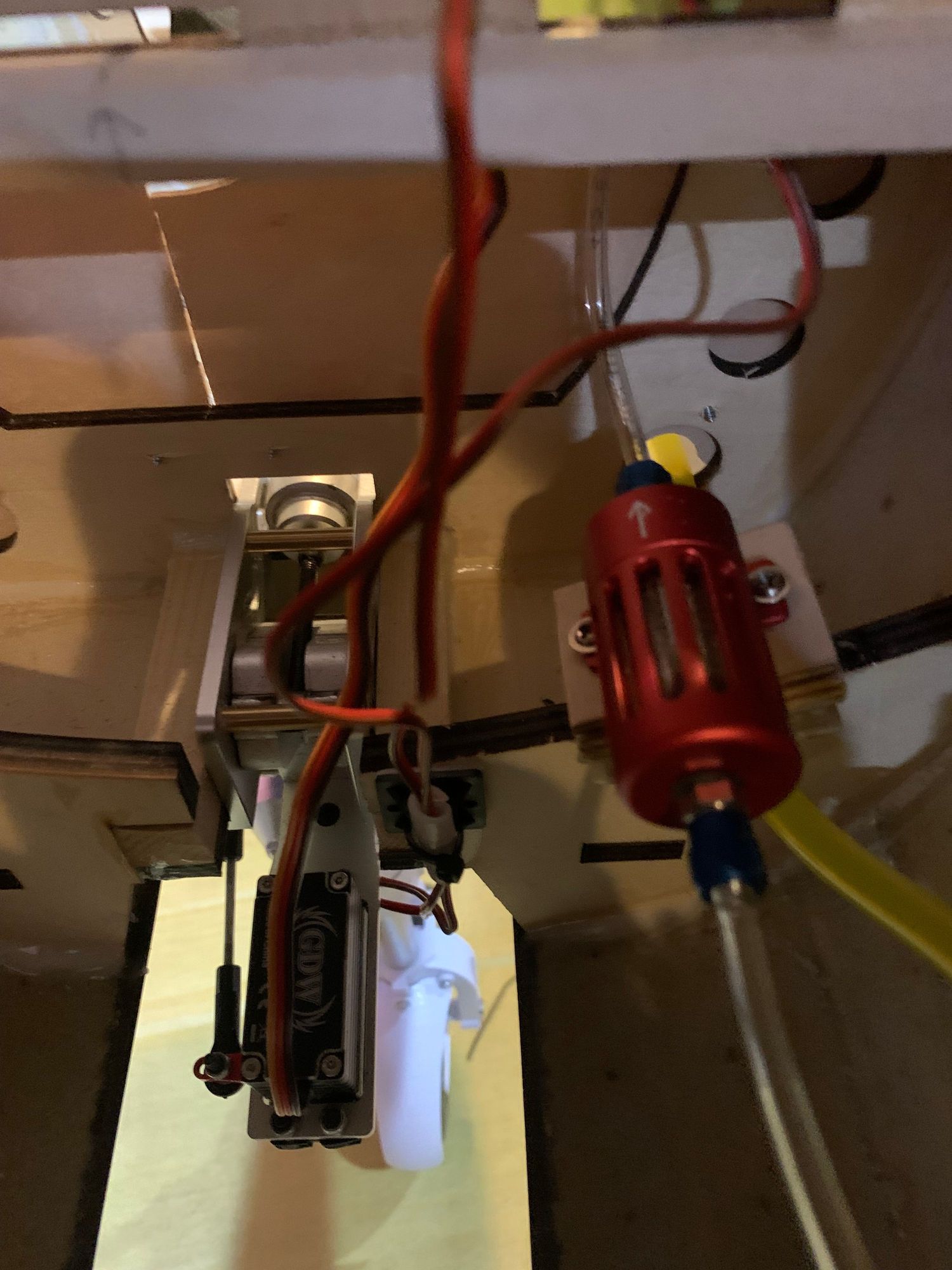

The servo lead from nose steering servo runs straight up and over tray to servo distribution box. To the right you will see the landing light wires tethered to the retract mount wood. That keeps the wires away from nose steering servo arm and the nose strut can cycle without the wires hanging up.
