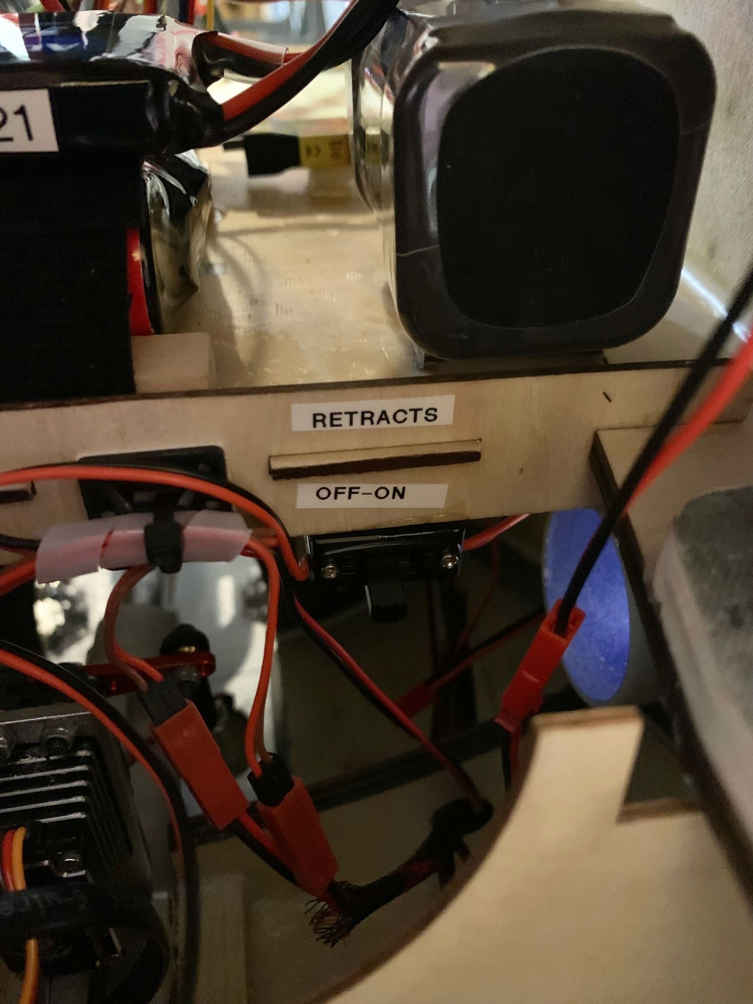

So it turns out the retract controller does not shut off when RX powered off. I decided to mount 2 switches under the front tray. Above is the switch on the left side which is plugged into a 2S lipo and then into both the retract and brake controller. The other switch plugged into 3S lipo and does lights
