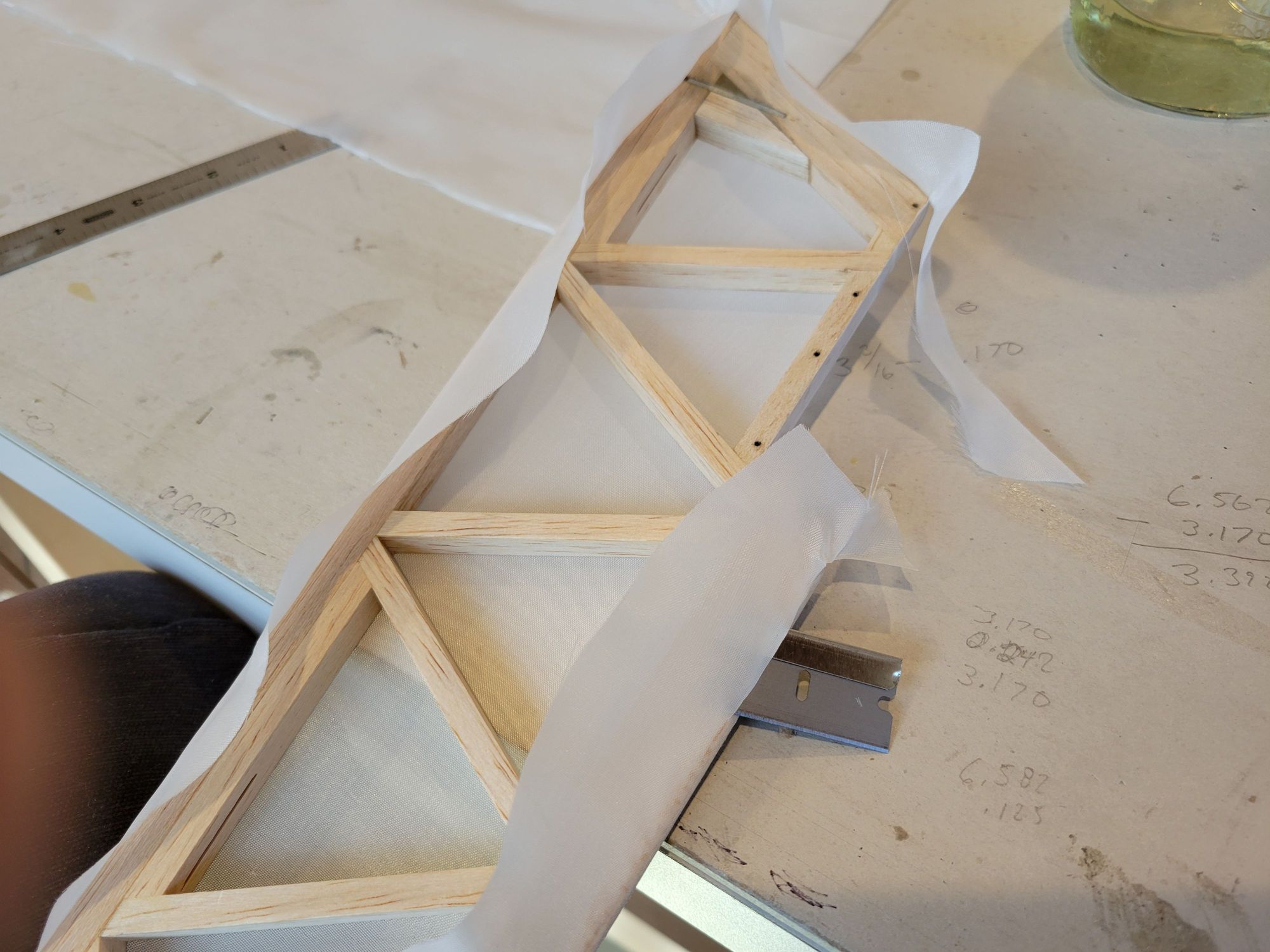

Before trimming the cloth with a sharp single edge razor two things were done. First, the fabric was shrunk with the iron just enough to get the fabric taught. There should not be any sagging or wrinkles. Second, to get a clean cut, 50%Nitrate and 50% Thinner was brushed over the edges of the cloth where the razor will cut. Let dry then trim.
