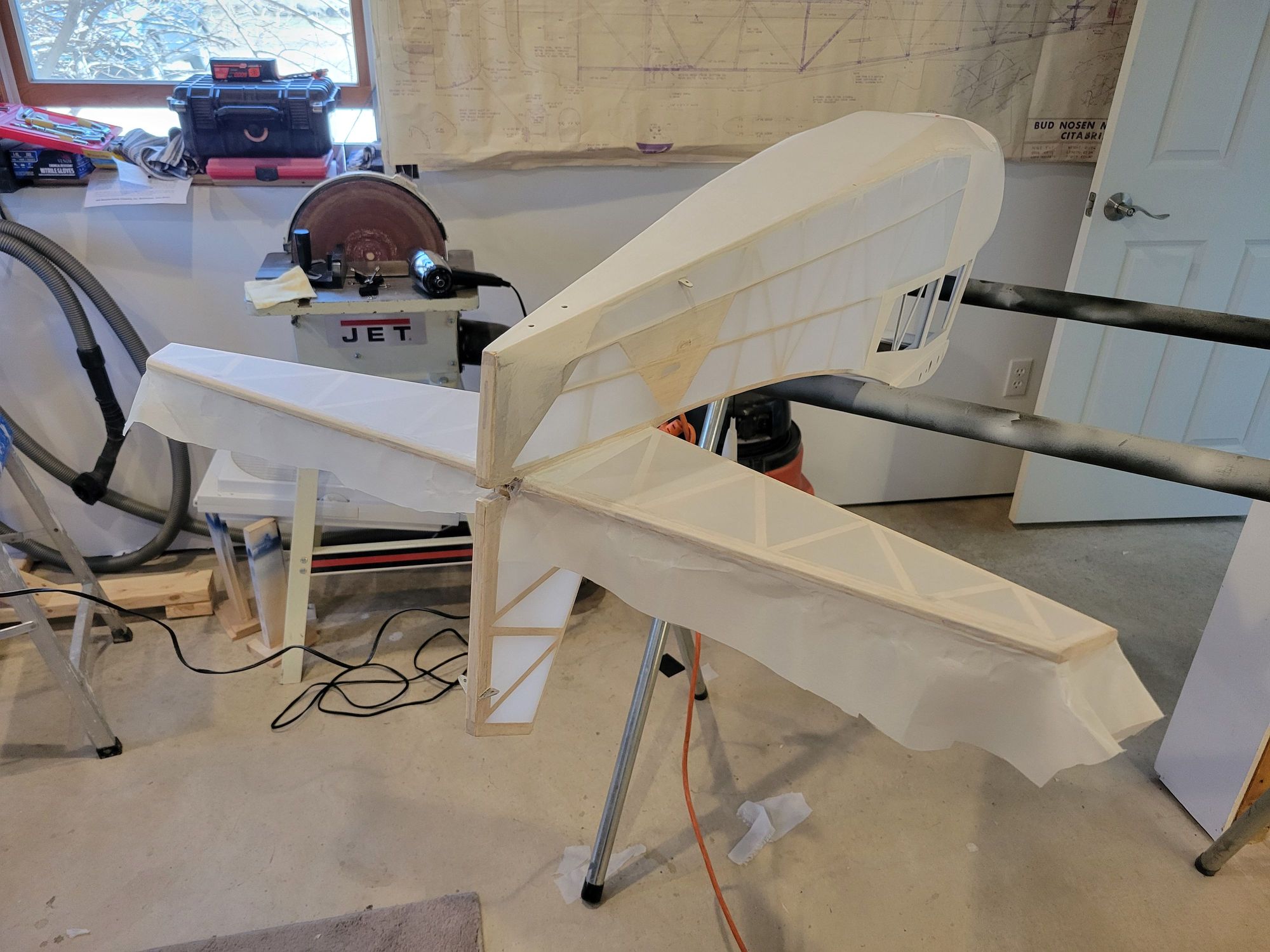

VincentJ April 17, 2025
The perimeter was ironed securing the cloth to the balsa. Before the excess fabric was trimmed, Nitrate dope was brushed on all the edges and allowed to dry. This makes trimming the cloth an easy affair without the cloth fraying.
