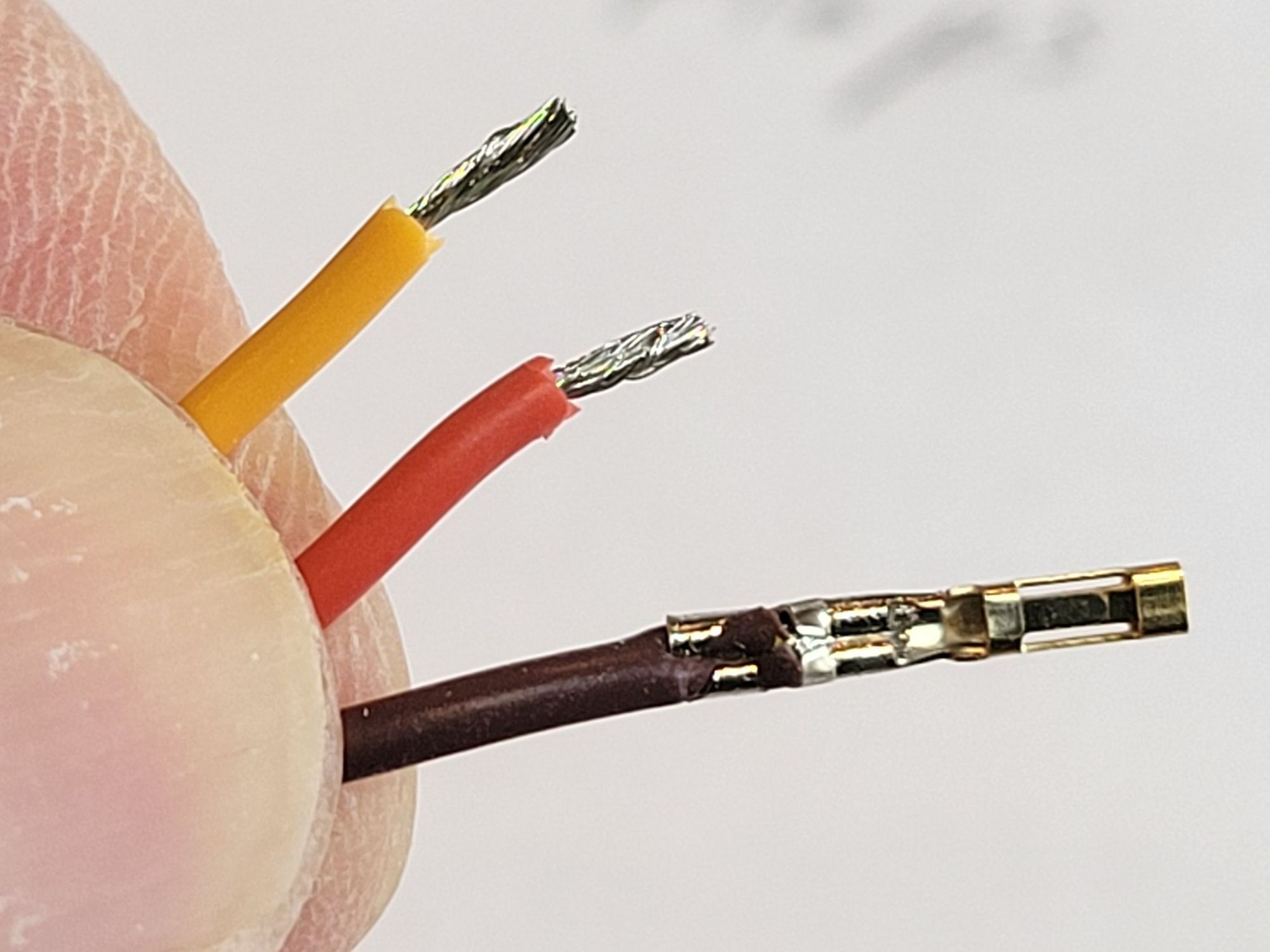

I've stripped off 1/8" insulation off each wire end. Here's a close up of a properly crimped (male) connector. Be sure to twist the wire ends before crimping. Note that there are two crimps, one securing the terminal to the wire insulation and the second to the stripped bare wire.
