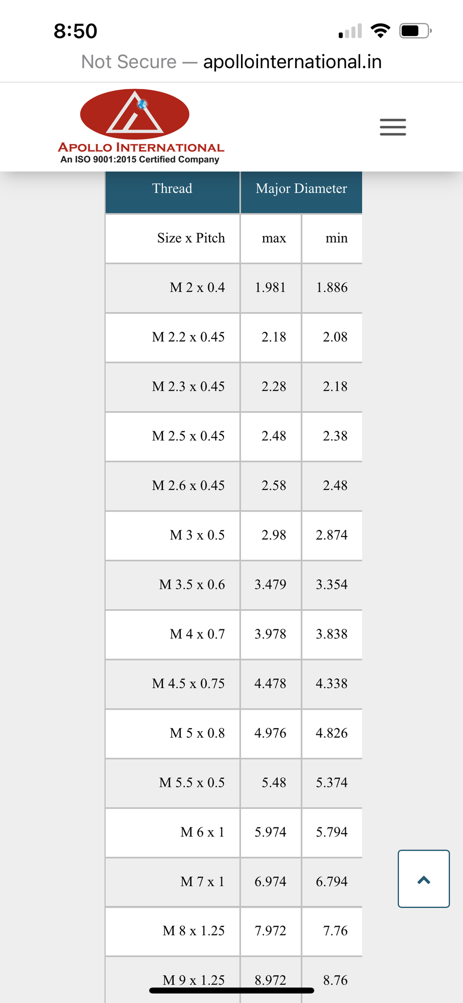

Note the OD size range. Deeply misunderstood by some;)
