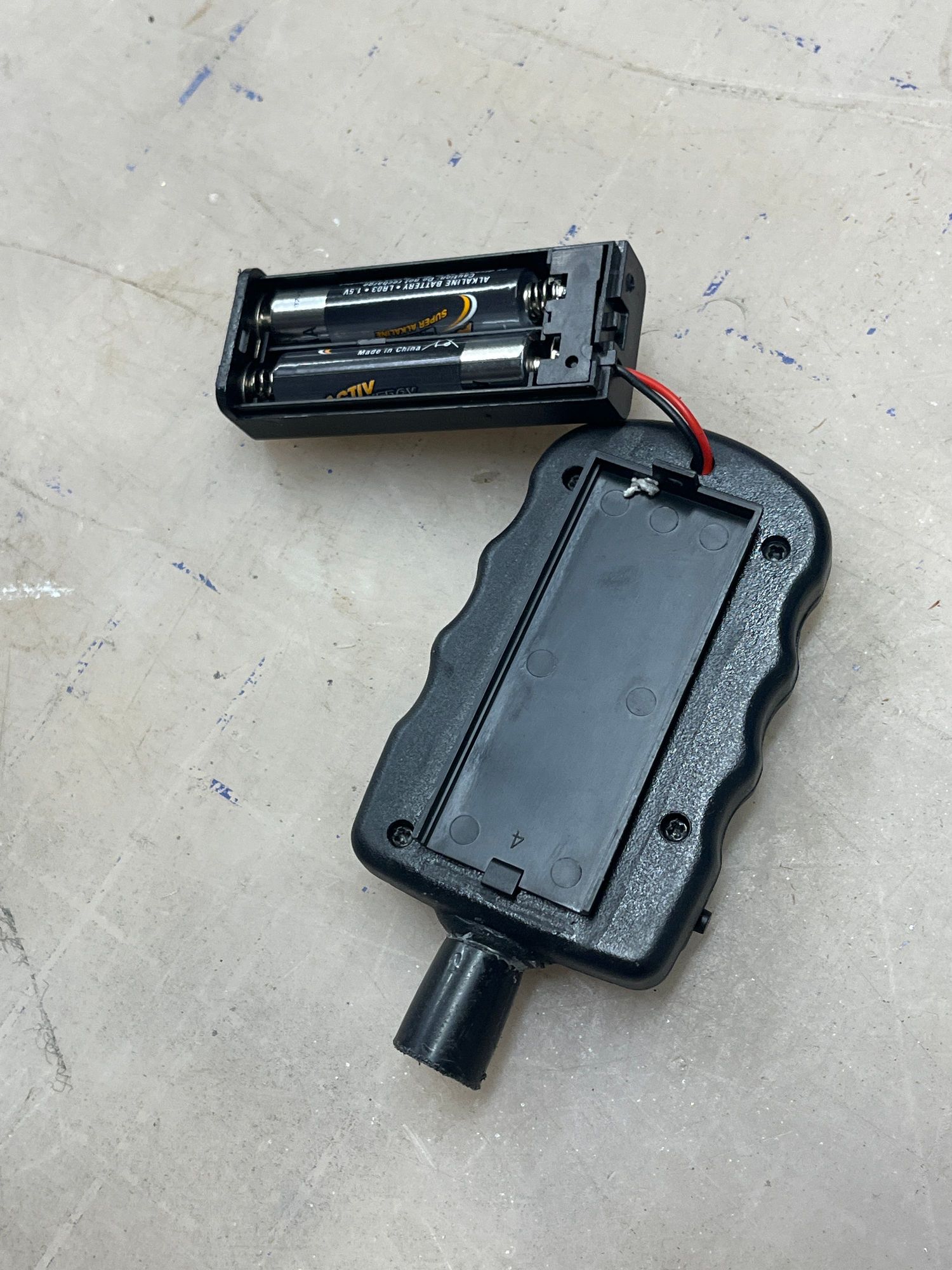

Piggy back AAA holder with slide switch. Turn it off at end of session and no more accidental turn ons in the meantime. Not only that, the easy to source batteries last an easy twenty or more times as long
