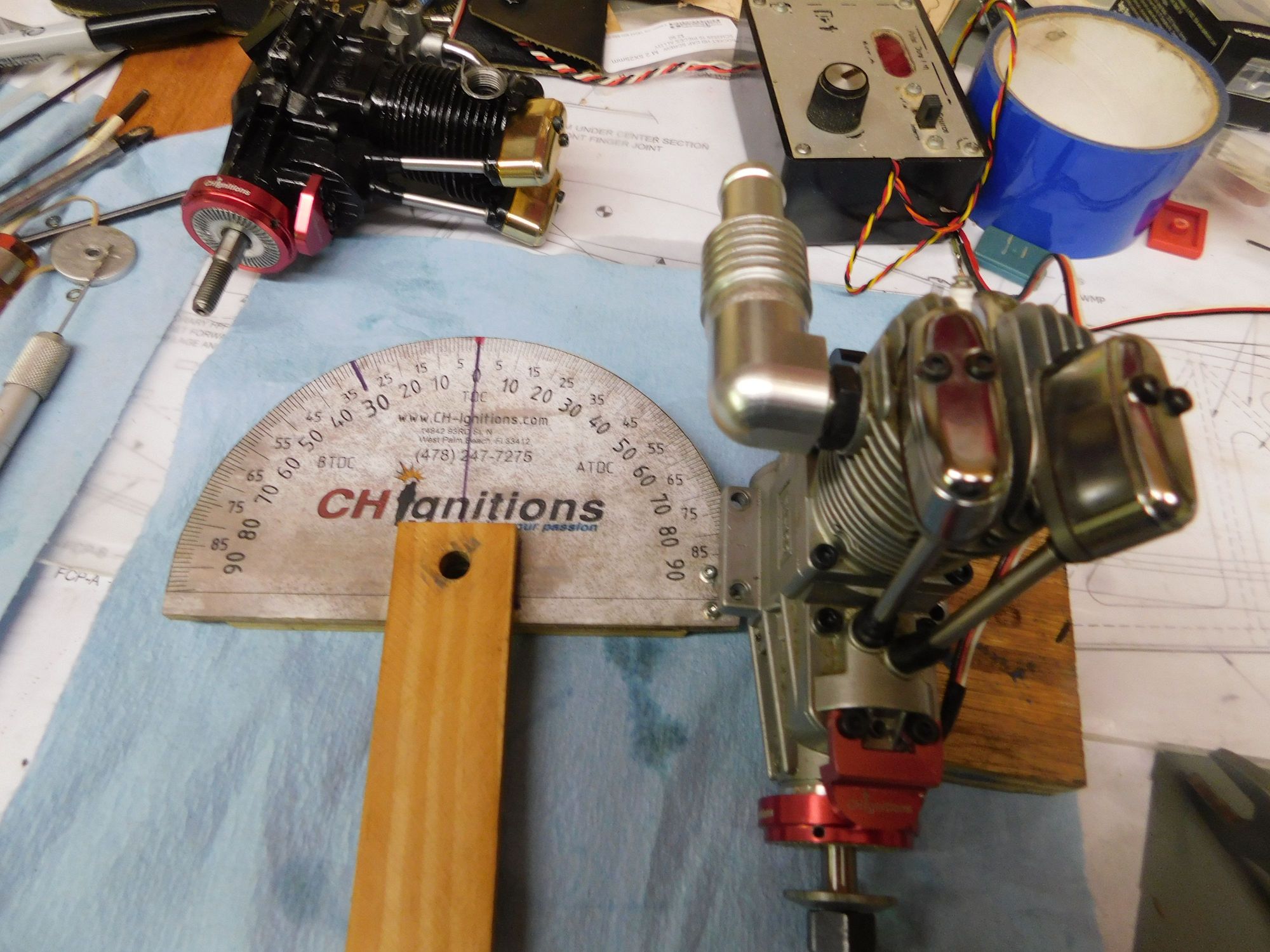

Here you go Jim, a 100 with a TurboHeader mounted without adapter and my probably over built degree wheel, it has a 4 oz lead weight on the back and carefully balanced wit the small screws on the right. I balanced it on a crankshaft with no rod or piston on it.
